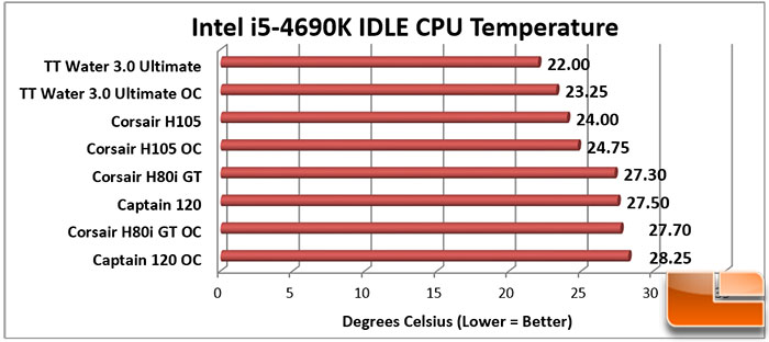

During the benchmarking process, we will run the Intel i5-4690K at both a stock speed of 3.5Ghz and an easy overclock to 4.4GHz. This is a very moderate overclock, and spending more time you would most likely be able to overclock it a bit more.

Benchmark Results: The Corsair H80i GT cooled exactly as I expected. Comparing the H80i GT to the DeepCool Captain 120, the H80i GT wins hands down. On some of the tests, the OC temperature on the H80i GT was pretty close to the Captain 120’s temperature running at base clock speeds. When stepping up to a larger radiator such as the H105 Extreme, that’s where we start to see the difference.
