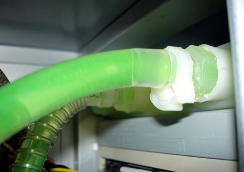

5.25 drive bay resevoir
5.25 Resevoir
The reservoir is designed to fit into any standard 5 1/4″ drive bay (Corsair recommends the highest bay available in your system). Constructed from high-density polyethylene for long term durability, and specially designed to operate efficiently with high-pressure high-flow pumps, this reservoir is built strictly for performance. While not super glamorous it features a stepped down discharge compartment which prevents air from being drawn into the pump, a typical problem in most reservoirs on the market which greatly reduces the systems heat dissipating performance.
The Corsair resevoir also features a dual inlet compartment allows the return of two devices installed in parallel (Chipset & VGA water-blocks, for example), thus reducing the overall pressure drop in the cooling circuit.

This is actually one of the nicest reservoirs I have ever dealt with. Extremely strong, extremely easy to work with, customizable, and fits perfectly into any 5.25 drive bay. I really like the step down feature which cuts down on air bubbles in the system. I don’t think most people out there realize the impact even a small amount of air trapped in your water cooling system can have on its performance.
mounted resevoir Fan mounting Kit
