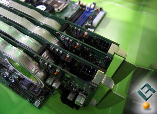

Once we got over the initial shock of the the Quad-SLI cards we started to think about power consumption. After taking a closer look at the 4 Printed Circuit Boards (PCB’s) we noticd that only two of the cards had the 6-Pin PCIe power connector. Knowing that these nVidia GeForce 7800 512’s need more power than what was shown we looked even closer.
