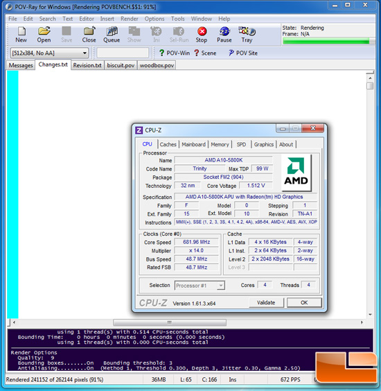

AMD A10-5800K APU Overheating
We opened up CPU-Z and noticed that the processor was seldom running at 4400MHz and at times it was dropping down to 500-800MHz. It was clear to us at this point that the stock cooler was unable to handle the heat from the overclocked AMD A-Series APU. AMD OverDrive showed the AMD A10-5800K was hitting around 80C in various benchmarks, but we aren’t sure if this was correct.
