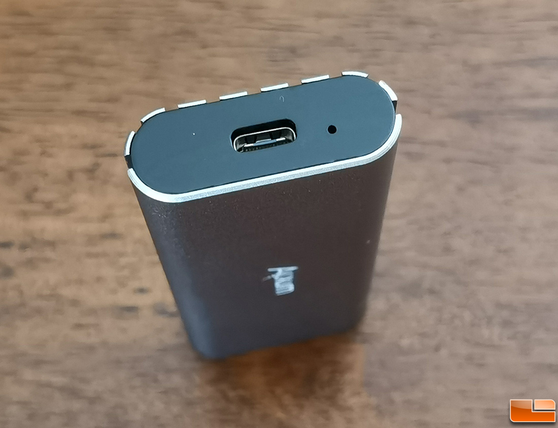

On one end of the Alxum Aluminum M.2 NVME SSD enclosure you’ll find the USB Type-C port and an LED status light. When portable SSD is on and at idle the light stays on, when data is being read or written it blinks and when the drive is in sleep the light cycles on for a second and then off for three seconds. As you can see from the image above there is a large gap around the USB Type-C connector and this enclosure has no IP (Ingress Protection) dust or water rating.
