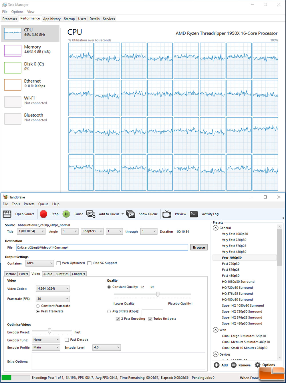

For the first benchmark test we used Handbrake v1.0.7 and used the Fast 1080p30 option to shrink down a Big Buck Bunny, Sunflower version 4K 60fps movie clip (download it here). This is a fun test as it’s a real world workload and something we often use. This application uses all 16-cores, but doesn’t put each core to full use. That means we end up with around 50-70% CPU usage on the AMD Ryzen Threadripper 1950X in stock form. The CPU Package Power was around 178 Watts, so this looks like a good test for a 180W TDP processor.

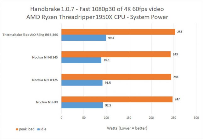

Lastly, there is overall system power draw that one needs to be concerned about as energy efficiency is an important thing to remember. It shouldn’t be too shocking, but the Thermaltake Thermaltake Floe Triple Riing RGB 360 came in with the highest idle and load power draws. This makes sense as it has three fans, a water pump and RGB lighting over the one or two fans on the Noctua air coolers.
