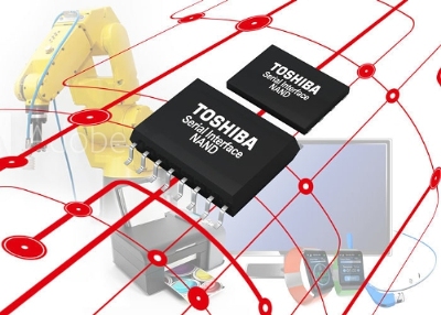

IRVINE, Calif., Oct. 21, 2015 /PRNewswire/ — Toshiba America Electronic Components, Inc. (TAEC)*, a committed leader that collaborates with technology companies to create breakthrough designs, today announced the launch of a new family of NAND flash memory products for embedded applications. Compatible with the widely used Serial Peripheral Interface (SPI), Toshiba’s new Serial Interface NAND can be used in a wide range of consumer and industrial applications, including flat screen TVs, printers, wearable devices, and robots. The Serial Interface NAND family consists of 12 products; includes three densities (1 gigabit (Gb), 2 Gb and 4 Gb); two packages (WSON*1 and SOP*2); and two power supply voltages. Sample shipments start today, and mass production is scheduled to begin with the 1 Gb products in December 2015. Mass production of the remaining products will follow.
Due to its compatibility with the SPI, Toshiba’s new product family can be controlled with just 6-pins, and can be utilized as an SLC NAND flash memory with a low pin count, small package and large capacity.

Key Features:
- Uses 24nm process technology for SLC NAND
- Compatible with the widely used SPI, which can be controlled with a low pin count of 6-pins
- Available in small and versatile packages. The WSON package size is 6.0mm8.0mm and the SOP package size is 10.3mm7.5mm. Products in the BGA*3 package are also under development, with sample shipments scheduled for the first quarter (Jan.-Mar.) of 2016. The packages and the pin assignments are compatible with common serial flash memories.
- Embedded ECC (Error Correction Code) with bit flip count report function
- Embedded data protection features
