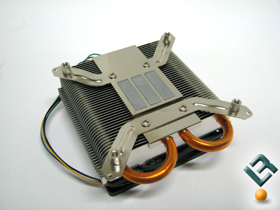

Both the Nano and the Micro use what ThermoLab calls Power Clamping Technology, or PCT to assemble the cooler. The base has small grooves cut into it and the fins are pressed into the base. This not only increases the surface contact between the fins and the base, but it also removes a rattle point. No rattling fins means less noise. The orientation of the heatpipes is also the same on both coolers. ThermoLab says this arrangement allows the cooler to be unaffected by mounting orientation, but as we will see later on, most boards can only mount coolers one way due to the design layout.
Both coolers bases are of the same design, and both come with TIM pre-applied to the base. The Nano (above) has a slightly smaller cooling area than the Micro. If it wasnt for the fin design, I would have a hard time pointing out which was a Nano or Micro base. Notice how the heatpipe loops stick out from the base, this is what will ultimately dictate how you mount the cooler on the board. I will show this in the next section. You may also notice the base looks off-center as well. It is off-center to the fins but it is on-center with respect to the entire footprint of the cooler.
