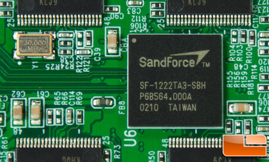

RUNCORE PRO V CONTROLLER
The SandForce SF-1222 (aka SF-1200) controller has been very popular and was the most prevalent controller after the decline of Indilinx drives in 2010. It employs its proprietary DuraClass technology for drive maintenance and on the fly error correction and requires no use of external cache for buffering. It thrives on compressible data due to its real-time data compression which boosts performance as you’ll see on the first benchmark. For that, head to the next page!
