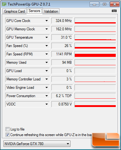

NVIDIA GeForce GTX 780 Idle Temperature:
gtx780-idle
The NVIDIA GeForce GTX 780 video card had an idle temperature of 31.0C in a room that was 22.0C (72F). Not bad for a graphics card that features over 7 billion transistors!

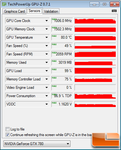

NVIDIA GeForce GTX 780 Gaming Temperature:
gtx780-gaming
When playing Far Cry 3 and Battlefield 3 for about 30 minutes each, we hit 80C and didn’t manage to go over that threshold since that is what the cards default temperature limit is. Notice the fan speed went from 1140RPM at idle to 2060RPM when gaming. You really can’t hear the card with it in your system at idle, but when you start gaming you can hear the fan a bit. Notice that the GeForce GTX 780 is hitting 1006MHz on the core clock when gaming.
