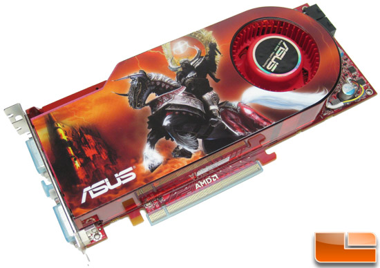

ASUS Radeon HD 4890
First up is the ASUS EAH4890, which features the standard reference clocks and is based off the reference design. The design looks just like a Radeon HD 4870, but the PCB is different and so is the heatsink that is found under the plastic shroud. The Radeon HD 4890 is a dual-slot card as you can see from the picture above.
