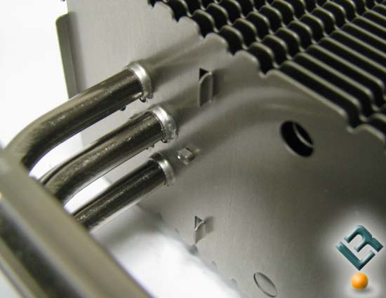

Looking at the bottom we can see how the cooling fins are soldered to the heat pipes.

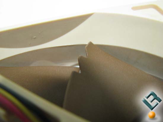

Now for the fan. The first thing you notice is the flesh tone plastic housing with brown fins. I know these are not the most appealing colors in the world, but the fan better perform exceptionally well for me to put up with these colors. The power cable is extremely long, ~12 inches. I think that it could have been good 6 inches shorter, but thats me.
Noctua NH-U12P
Looking a little closer to the fan blades we can see one of the things that give the fan an amazing low 19.8 dBA rating – The Vortex Control Notches (read more about the design here on Noctuas site). The other noise reducing feature is the self-stabilising oil-pressure bearing (SSO bearing) of the Noctua NF-S12 and NF-R8 series surpasses current types of ball, sleeve or liquid bearings in terms of long-term stability and quietness. You can read more on the design here.
