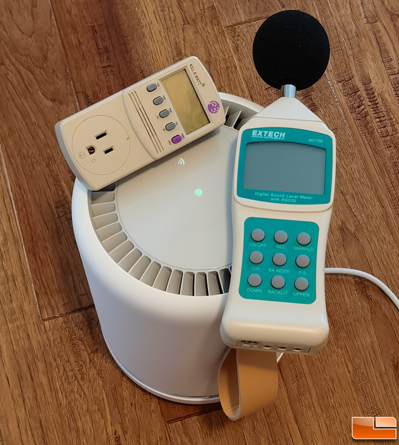

Some of the testing that we wanted to do on the Molekule Air Mini+ was to check the power consumption and the noise levels. Notice that the top of our unit has a green light. This is the particulate matter level indicator and green is the best color that you can have as it indicates low levels of particulates. Yellow is considered moderate, red is bad and purple means that you have the highest level of particulate matter in the room. If your indicator is not green then you should increase the fan speed to increase the cleaning speed of the air in the room. This will be done automatically if the ‘auto protect’ mode is enabled that adjusts fan speeds when needed.

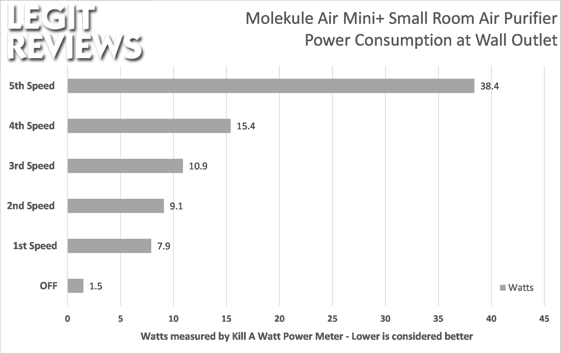

When it comes to power consumption at the wall outlet we were pleasantly surprised by the results as Molekule rates the power consumption at 20 Watts on low and ~55 Watts on high. We found the unit used 1.5 Watts turned off, ~8 Watts on the lowest speed and ~38 Watts at its highest speed. We’ve found that the 3rd speed level is the setting we like to leave it at for 24/7 use and that uses about 11 Watts of power. If your electric costs 14 cents per kilowatt-hour you are looking at an annual expense of just under $13.50 per year if you draw 11W for the entire year 24/7.

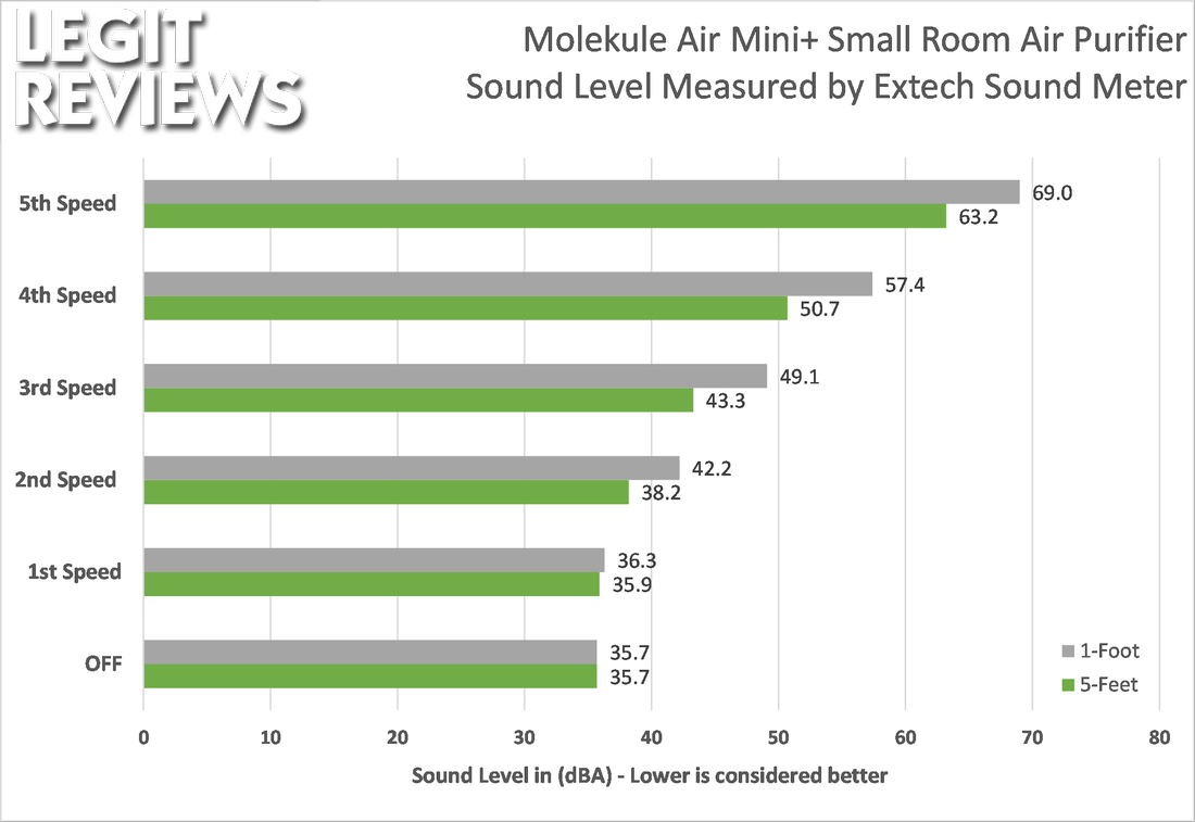

We mentioned that we liked leaving ours on the third power level and that is because of the noise levels from the Molekule Air Mini+. It rated at 39dBA at its lowest speed and 62 dBA at its highest speed. We measured the sound levels at distances of 1-foot and then again at 5-feet. The lowest speed blends in nicely with the background noise of a home or office that might have ceiling fans or a refrigerator running. Once you get up to the 2nd speed you’ll hear it over the background noise, but it is a nice white noise that is simple to become accustomed to. The highest speed is loud and it came in over 60dBA at both distances that we checked at. This is a speed that you’ll only want to use when the air quality is poor and you are looking to circulate all the room in the air as quickly as possible.

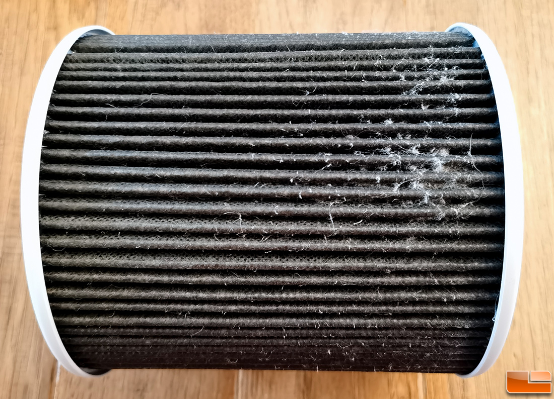

We’ve used the Molekule Air Mini+ for nearly six months now on the dresser in our bedroom. The air comes in the bottom of the unit via the units 360 degree air intake and this was obvious by looking at the filter. The bottom of the filter had more ‘dirt’ trapped in it. Molekule says their PECO filter is nanocatalyst coated and reacts to the internal light to oxidize indoor pollutants, including viruses, bacteria, mold, allergens, VOCs, and even ozone. Photo Electrochemical Oxidation (PECO) technology has not been tested on Covid-19 and remember that no air purifier can completely reduce the risk of exposure to viruses.
We did not rent a air quality meter for this review as it is tough to see if the photocatalysis process is working to speed up oxidation that breaks down pollutants at a molecular level. Most test equipment just shows air filter effectiveness based solely on how well large particles are captured and removed from the air. Lower airflow is actually better for the photocatalytic processes, so the number of times the air in the room is exchanged also isn’t a good measurement tool any longer. The photocatalytic processes is a rather new process and tough to measure outside the lab and in a home.
Here is a closer look at the filter after nearly 6 months. Not really that bad looking for a family of four with two dogs after almost 6 months, but we don’t smoke and it was kept elevated up on the dresser. That said, traditional HEPA filters generally trap impurities as they pass through the filter, while this PECO technology is supposedly capable of destroying the impurities as they pass through.
