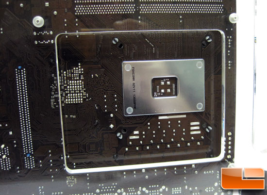

Microcool Banchetto 101 CPU cut out
The CPU cut out does give me enough room to swap out CPU cooler backing plates.

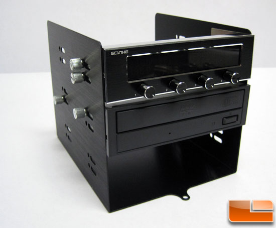

Microcool Banchetto 101 optical drive bay
Then I installed the optical drive and fan controller.
