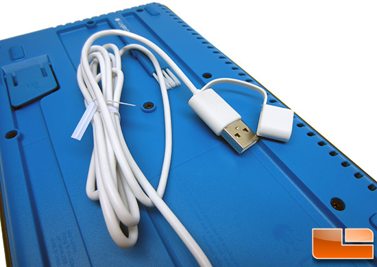

Flipping the keyboard over you can see that the Logitech K310 has drainage holes around the back of the keyboard for speedy drying and is has a blue color.
The back of the keyboard also has the cleaning instructions on it. They basically say to cap off the USB 2.0 header and to rinse it off in a sink or small bucket. The Logitech K310 is submersible in up to 30 cm (11.8 inches) of water and can withstand temperatures of up to 50C (120F) for up to five minutes. This washable keyboard looks like it would be easy to rinse off and dry, but don’t put it into the dishwasher! We were told that the dishwasher gets too hot and the cycle takes too long. So, this keyboard is hand wash only with a soft cloth in warm water!
You can also see the cleaning brush that attaches to the back of the keyboard to clean around and under the keys when they get dirty. The back of the keyboard has five rubber pads to prevent your desk from getting scratched and a pair of tilt legs that put the keyboard at an 8 degree angle.
The Logitech Washable Keyboard K310 uses a USB connection and the cable is 5.9 ft. or 1.8 M long with a cap to help keep water out of it when being washed. This keyboard is plug and play, so there is no software to install and it works on Windows XP, Windows Vista, Windows 7 and Windows 8.
