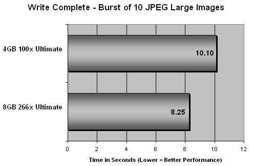

Write Complete Speed Testing:
When it comes to the speed of the Kingston Ultimate CompactFlash series we used a stop watch to record the time it took for 10 pictures to be taken in the sports mode in rapid fire. For this test we compared our two year old Kingston 4GB Ultimate Compact Flash card (Ultimate was 100x back then) to the new Kingston 8GB Ultimate 266X CompactFlash card.
A difference was actually noted when looking at the time it took for the write to complete between the 100x and 266x cards! The Kingston 8GB Ultimate 266X CompactFlash card completed writing the data 22% faster than the Kingston 4GB Ultimate 100X CompactFlash card that we have been using for the past couple years.

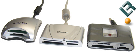

Media Card Reader Testing:

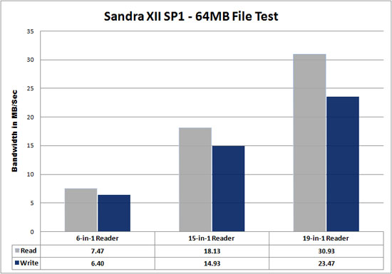

The Kingston 8GB Ultimate 266x CompactFlash card comes with transfer rates of 45MB/sec. read and 40MB/sec. write, but that doesn’t mean you will hit them. In a recent article on the Kingston 19-in-1 media reader we tested this memory card on three readers and got very different results. We found that none of the readers we looked at were able to reach the cards rated transfer speeds.
The best read speed we could pull off was 31MB/Sec and the write seed was just 23MB/Sec, which is shy of the 45MB/Sec read and 40MB/Sec write that we wanted to see. All card readers are different though, so be sure to use a good reader if you get an Ultimate card!
