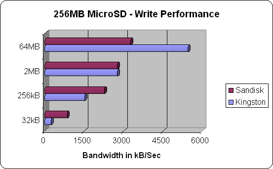

When it comes to the write scores Kingston started off behing in the 32kB file size test, but by 2MB it was nearly tied with the Sandisk and then blew it away at 64MB. When writing a 64MB file the Kingston card was able to write at 31x compared to the 18x on the Sandisk.
