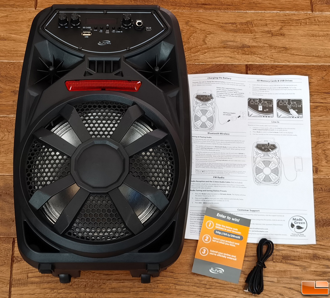

iLive ISB380B Tailgate Speaker Retail Box
Inside the full color packaging you’ll get the tailgate speaker, 1-page instructions a micro USB to USB Type-A charging cable and an invitation to review the speaker for a chance to win a $150 gift card. No remote is included, so everything will be done on the front panel of the device.
Right off the bat we noticed that the unit was super light once we removed it from the retail packaging. The entire weight of everything was 5 pounds and 7.4 ounces. The retractable handle and roller wheels are fun for kids to move it around, but serve no real purpose for adults. Weight is usually a pretty good sign of quality, but this is an inexpensive speaker and this was sort of expected.
iLive ISB380B Tailgate Speaker Fake Ducts and Ports
The next thing we noticed is that the front speaker ports and baffles are all fake. It looks cool from a distance, but they are closed off and serve no purpose.
iLive ISB380B Tailgate Speaker Controls
The controls on the front of the iLive ISB380B Bluetooth Speaker are fairly simple to use. You have a simple knob that powers the unit on and increases the volume. A mode button lets you switch between Bluetooth, FM Radio and USB or micro SD card inputs. Bluetooth is in opening pairing mode, so you just need to turn it on and connect to it!
You also have a microphone line in that allows you to speak to a crowd or sing along with your favorite songs. Two knobs on the far left side allow you to adjust the mic level and do an echo effect if that is what you are after. A long press of the hold button is supposed to turn on/off the color changing LED light that sits over the speaker, but ours did not work.
To charge the iLive ISB380B Bluetooth Speaker there is a micro USB input on the far right side of the front panel. The speaker can’t be used while it it charging, so be sure to fully charge it before use. The official battery life ratings are 6 hours at 50% volume and 2.5 hours at 100% volume.
