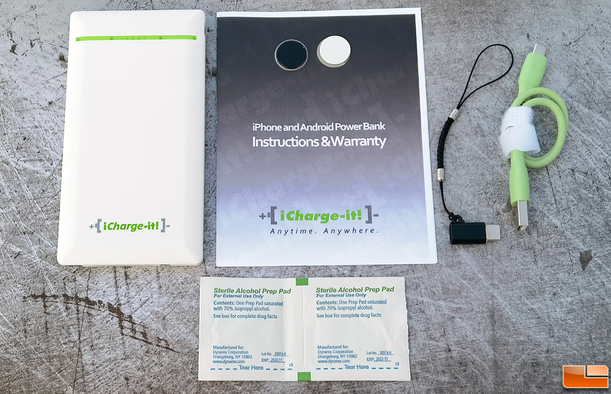

Inside the box you’ll find the power bank, two alcohol cleaning pads, black and white steel discs with 3M adhesive tape pre-applied, micro USB to USB Type-C adapter, USB Type-A to micro USB charging cable and the instructions. The instructions are also available online, so feel free to take a look at them.
