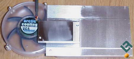

of the cooling fan from normal to low speeds. The bottom of the IceQ cooling
heat sink is also shown below. The surface that looks almost like a mirror
finish is the portion that sits on the core. The last comment I have regarding
the IceQ system is that it does not sit flush with the back panel of the
card. I would think in order to efficiently remove the heat from the case,
it would need to be flush so the heat does not re-enter the case, especially
with the lack of air flow provided by this fan.

![]() HIS 9800 Pro with the IceQ cooling removed |
![]() Bottom of IceQ cooling system |
![]() The Core |
