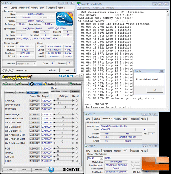

For the overclocking tests I first tested max bclk stability through Super Pi 1M and 32M. This is in no way a test of 24/7 stability but rather benching stability. However the 32M test does give you a rough estimate as to how it would overclock for 24/7 usage. I limited myself to 1.35vCPU, 1.30vtt, 1.65vdimm, and 1.8vpll. For the 229MHz bclk I needed a minimum of 108MHz PCIe while the 227MHz bclk only need 105MHz PCIe. I was able to run stable up to 114MHz PCIe so with more volts I imagine there are more bclk opportunities.

SuperPi 32M was a bit strange with regards to stability. I could run 32M at 228MHz bclk but the entire system would act as though it was slowing down but continue updating the screen and running the benchmark. More vtt would solve this problem with ease.
