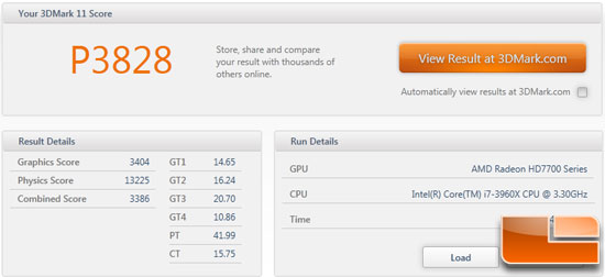

Gigabyte Radeon HD 7770 OC at 1000MHz core and 1250MHz memory:
Radeon HD 7770 Stock
Gigabyte Radeon HD 7770 OC at 1060MHz core and 1300MHz memory:
Radeon HD 7770 Overclocked
We tried out this overclock with Futuremark 3DMark 11 on the performance preset and saw the score go from P3828 to P3993, which is a 4.3% or 165 3DMark point increase from the card’s stock settings. This is the third AMD Radeon HD 7770 video card that we have overclocked and we have yet to get one past 1175MHz, so this card is just 15% shy of the best that we have seen. It appears that the factory overclock is pretty decent and not too much headroom is left in these cards.
