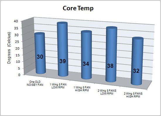

I ran several different tests with these fans. The first using my old case fan, one new Wing 8 fan on its low RPM setting, one Wing 8 on high RPMs, 2 Wing 8 fans on low RPMs and 2 Wing 8 fans on high RPMs. All tests were done while my computer was running a distributed computing program called Folding at Home. The results are shown in the graphs below. The old single fan I had been using ran at a much higher RPM than the new fans running at their highest setting. The Wing 8 fans ran at a slower speed in order to keep the noise level down. The fans only produced 21 dBA. The reduction in noise was worth it to me, though. The new Wing 8 fans are the quietest case fans I have ever used.
Gelid Wing 8 Fan Speeds
When running a single fan, it is mounted on the back of the computer blowing the hot air out. The second fan I installed in the front of the computer, and used it to blow cool air into the case. The results were interesting because it showed that running 2 Wing 8 fans, while quieter, ran hotter than using the old case fan I had.
