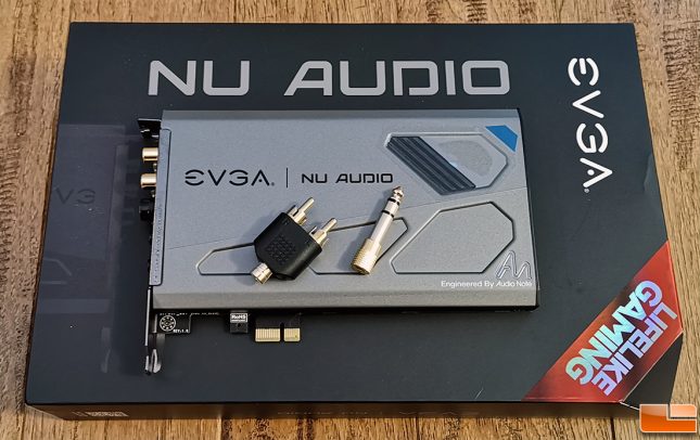

The EVGA NU Audio card comes with a 6.35mm to 3.5mm jack adapter as well as an RCA to 3.5mm jack adapter, so you shouldn’t have to buy anything to use it.

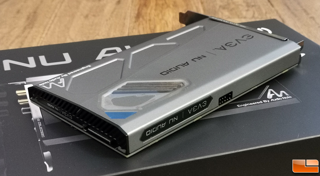

EVGA NU Audio Card

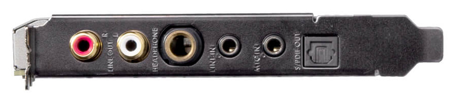

When it comes to inputs and outputs the external I/O arrangement on the EVGA NU Audio should cover most folks. You have a 6.3mm headphone output, 3.5mm line and microphone inputs, dual RCA (L&R) outputs and finally the S/PDIF out.
NU Audio IO

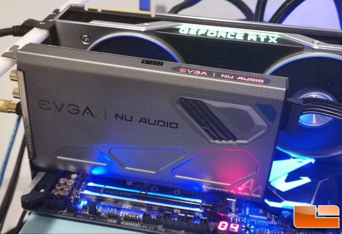

The SATA power connector is located on the end of the card and the front panel audio header is located on the top of the card. This makes cable management a bit tricky especially if you have a video card with axial fans. The EVGA NU Audio uses 8 Watts of power delivered from the SATA header to ensure the audio isn’t interfered with.
EVGA NU Audio Power

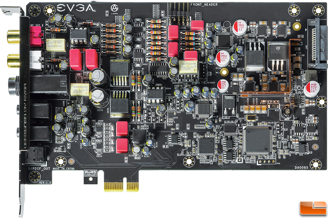

Here is a quick look at what is under the cover. You can see the copper shielding cover to the left of the SATA power connector that reduces EMI and other features of the card with the cover off.
Nu Audio Bare Card

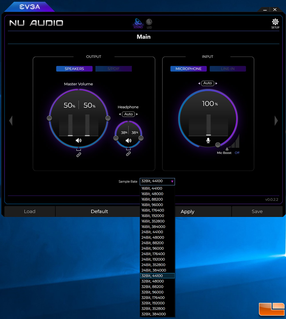

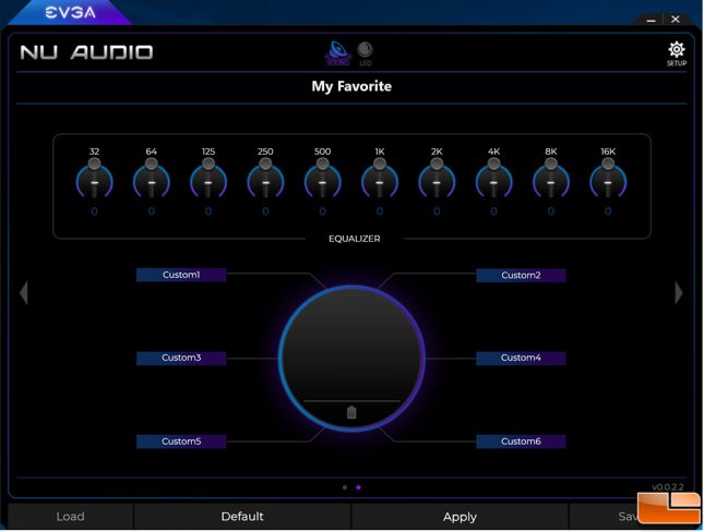

The driver is just over 6MB and the EVGA NU Audio software utility is simple to use. On the main menu you can adjust input and output volume / level controls. You can also change the headphone volume separately from the master volume, which is nice. The sample rate can be set with the base being 16-bit, 44100 and the max being 32-bit 384000. The look and feel of the GUI should be familiar to anyone that has used EVGAs Precision X1 utility for graphics cards.
EVGA NU Audio Software
If you arrow over to the next menu option you’ll find the utilities 10-band equalizer. This allows end users to adjust the frequency levels for 32Hz to 16KHz range and then save them to one of six available preset locations.
EVGA NU Audio Software - EQ

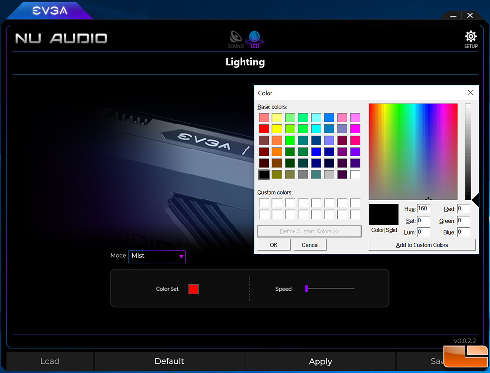

Lastly, there is the RGB lighting control menu that allows you to set the color of the top display and then the lighting effect mode. The lighting modes include popular settings like pulse, mist, solid, rainbow and so on.
