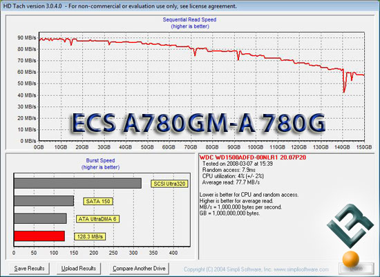

HD Tach RW; Version 3.0.4.0
HD Tach will test the sequential read, random access and interface burst speeds of your attached storage device (hard drive, flash drive, removable drive, etc). All drive technologies such as SCSI, IDE/ATA, 1394, USB, SATA and RAID are supported. Test results from HD Tach can be used to confirm manufacturer specs, analyze your system for proper performance, and compare your performance with others. HD Tach is very easy to use, quick, and presents data in easy to read graphs, including the ability to compare two storage devices on screen at the same time for easy analysis.
Benchmark Results: Using a Western Digital WD1500ADFD Raptor hard drive as a secondary drive we tested hard disk performance on the 780G platforms and the results are shown above. Both the ECS and Gigabyte boards had the same random access score and the burst speed and average read speeds were too close to call a winner.
