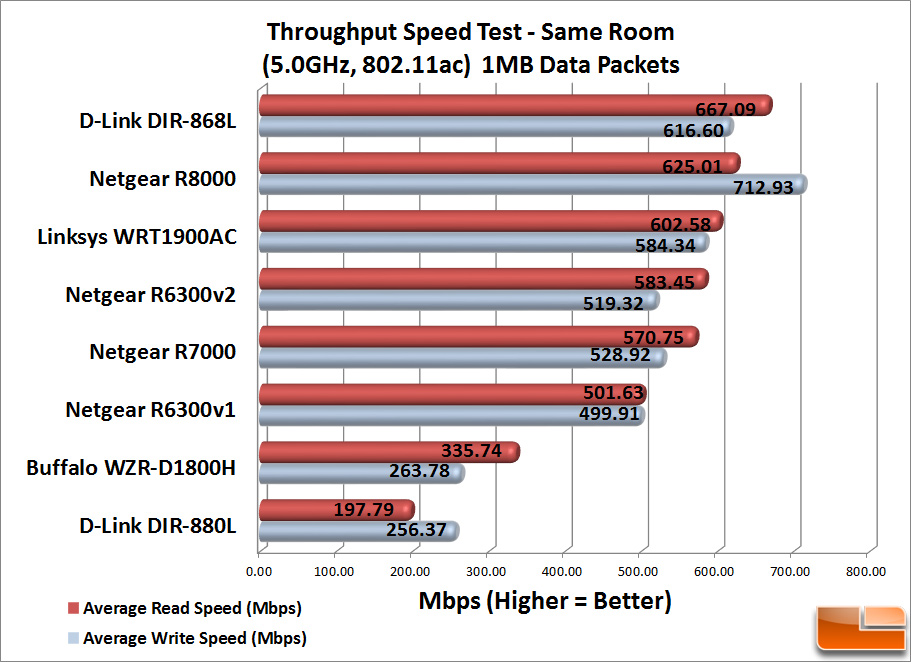

Benchmark Results: We first look at 1MB sized packets in the same room and found that the D-Link DIR-800L didnt exactly light up the place. In fact, the 880Ls performance was so low in the same room as our test laptop/bridge, we thought our unit was broken. After confirming the firmware and having a chat with some D-Link engineers, we confirmed the numbers that are published above. Compared to the older D-Link DIR-868L, the DIR-880 is outperformed by a whopping ~300%! We are hoping this is not an indicator of general performance.

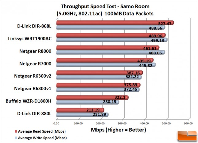

WiFi_Speeds_SameRoom_100MB
