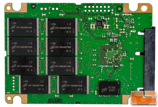

The first side shows eight of the sixteen total NAND modules as well as the Micron branded cache along the edge of the board.
Crucial M4/Micron C400 NAND
The 25nm NAND is Micron in manufacture and each is 16 GB in density for an overall capacity of 256 GB (in terms of hardware storage 1 GB = 1,000,000,000 bytes). The NAND is rated for 3,000 program-erase (PE) cycles whereas the Intel 320 Series drive we recently tested listed their 25nm NAND as rated at 5,000 PE cycles. They even state in the specifications that 40 GB of writes a day would put the life at five years. Either way, the NAND is likely to outlast its relative usefulness before the user upgrades and NAND loses its charge after roughly 10 years anyway so no one is expecting them to last forever. The speed at which these drives are improving; in just a few years they will be looked at like we see 5400 RPM drives vs. a 10,000 RPM drive today.
