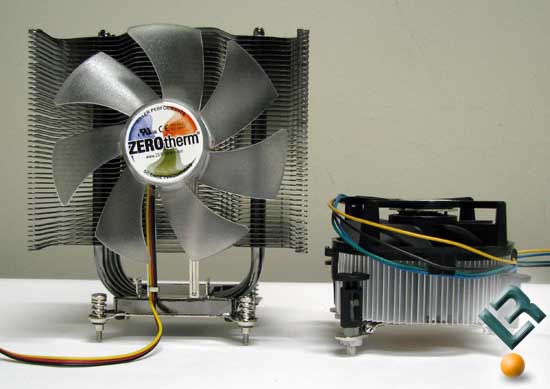

The ZEROtherm NV-120 Nirvana is the second to largest cooler in physical size at 95 x 128 x 150mm (LxWxH), and, oddly enough, it is the lightest of the group at 638g. The Nirvana is also (to me) the sharpest looking cooler of the bunch with a very nice gunmetal finish.
Cooler Round UP - ZEROthrem NV-120
Looking from the side we can see the size of the heatpipes a little better. The Nirvana sports 4 U shaped heatpipes giving it 8 vertical pipes; it also has a 120mm blue LED fan and separate adjustable fan control.
