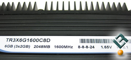

As previously mentioned, the Corsair TR3X6G1600C8D memory kit comes with XMP memory profiles which is great for those using a Core i7 motherboard that supports these profiles. You just need to enable Intel XMP memory profiles and the BIOS will be properly configured and you’ll be on your way. The ASUS P6T Deluxe motherboard does have XMP settings in the BIOS, but if you don’t enable them before firing up the system for the first time, the system will boot up with pre-programmed JEDEC default values. That means this kit will boot up at JEDEC standard 9-9-9-24 values at 1333MHz if the bios has just the default settings loaded. If XMP is enabled it will then automatically change to 8-8-8-24 values at 1600MHz. If you still like to set things manually, you can just read the label on the memory modules and everything you need to know is printed right there on it, which is nice and something very few memory companies do these days.

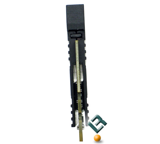

Taking a closer look at the newly re-designed Corsair DHX heat spreaders we can see that they differ greatly from the original Dual-path Heat Xchange (DHX) design that we covered here in 2006. The heat spreaders made full contact with all the memory ICs, so no flimsy heat spreaders here.

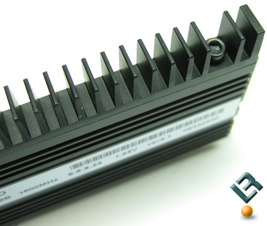

The new DHX design has a top heat sink that is held down by three Allen head screws, which seems odd unless you’d be able to change out the top plate as the old design worked just fine. Notice the fins to help dissipate the heat from the memory modules.

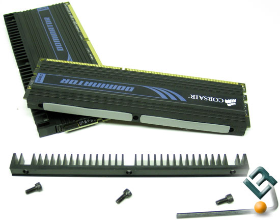

Intrigued by these mysterious Allen head screws I grabbed a 3/32 Allen head wrench and removed them. Under them I found some double sided thermal tape and a solid flat surface. I guess we’ll have to figure out the reasoning behind this design down the road.
