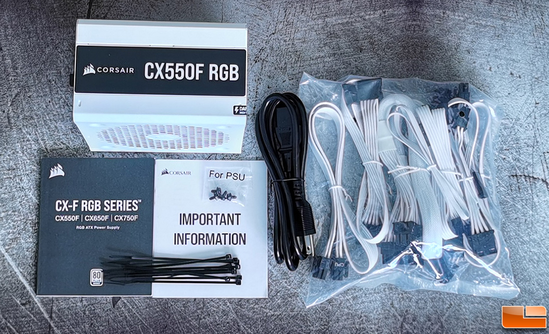

You’ll also find the instruction manual, warranty manual, zip ties for cable management, power supply screws to mount it to your case, a power cord and a bag full of cables. It would have been nice to have a storage bag for the cables rather than a non-resealable plastic bag, but that likely helped keep costs down. The cables themselves are flat and with the exception of the ATX 24-pin connector as it is actually sleeved. The ATX 24-pin is 610mm in length and the 4+4 pin EPS/ATX12V is 650mm in length. That is plenty for most motherboards. The 6+2 pin PCIe, SATA and 4-pin Molex cables range in length from 700-800mm. The LED cable is 500mm and the 5V ARGB adapter is 300mm in length. These usually plug into a header at the bottom of a motherboard, so their shorter length shouldn’t cause any issues.

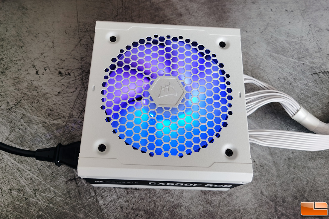

The cooling fan inside is labeled Corsair NR120L that holds eight RGB LEDs and that is a new model to us. We had to ask Corsair, but this fan was designed just for use on their power supplies and uses a rifle bearing. Rifle bearings are similar to sleeve bearings, but are quieter and have a lifespan much like ball bearings.
One the outside end of the power supply you have the power cord connector, on/off switch and the RGB lighting button. This is the button that you need to press and hold for free seconds to cycle through the 9 RGB lighting presets. If you short press the button it will change the lighting color on the preset that you are currently on. It is simple to do and something that you can do from the outside of your case.
