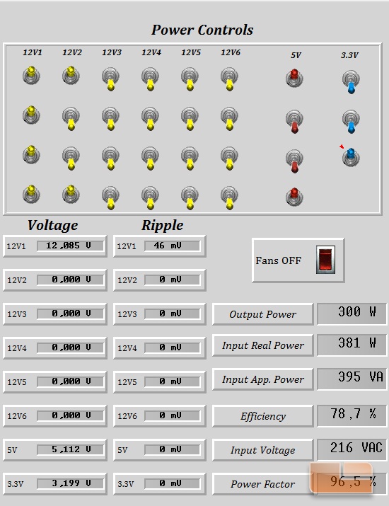

The load
In order to be able to effectively and efficiently test any computer power supply unit, we developed and constructed our own proprietary testing station. Our testing station consists of a number of power resistors and small capacitors, which in turn are connected to a RS485 electronic relay array which allow our load to be controlled through computer software alone.

The software
