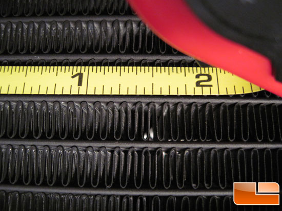

The fin count for the radiator is around 20-21 fins per inch. This tells me that the vantage will do better with higher CFM fans. When it comes to radiators the more fins per inch the higher the CFM and static pressure rating your fan needs to be.
