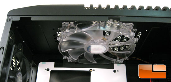

Cooler Master Sniper Black Edition Top Fan
At the top of the case we have the top 200mm fan. This can be swapped out for two 120mm fans or 120x240mm radiator.
