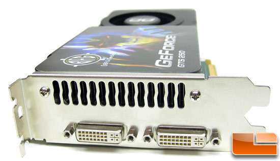

The air from the cooling fan blows air across the inside of the plastic fan housing over the heat sink and is exhausted out the rear of this dual-slot card. The picture above gives you a visual reference for where the hot air goes. This picture also shows the rear output connectors on the BFG Tech GeForce GTS 250, which are a pair of dual-link DVI-I connectors.
