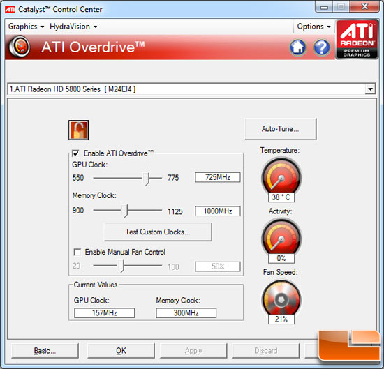

ATI Radeon HD 5850 Idle Temperature:
ATI Radeon HD 5850 Idle Temperature Testing Results
At idle the Radeon HD 5850 had an idle temperature of 38C, which is identical to the Radeon HD 5870’s observed idle of 38C. When we first looked at the Radeon HD 4870 in June 2008 we found that it had an idle temperature of 74C. As you can see from the screen shot above, the idle state of the Radeon HD 5850 drops the GPU frequency down to just 157 MHz and the memory down to 300 MHz to help conserve power and lower temperatures. The idle states appear to be the same between the two cards, so the slight temperature difference is likely due to one GPU being less ‘leaky’ than another. AMD has nailed idle temperatures on this series from the looks of it.
