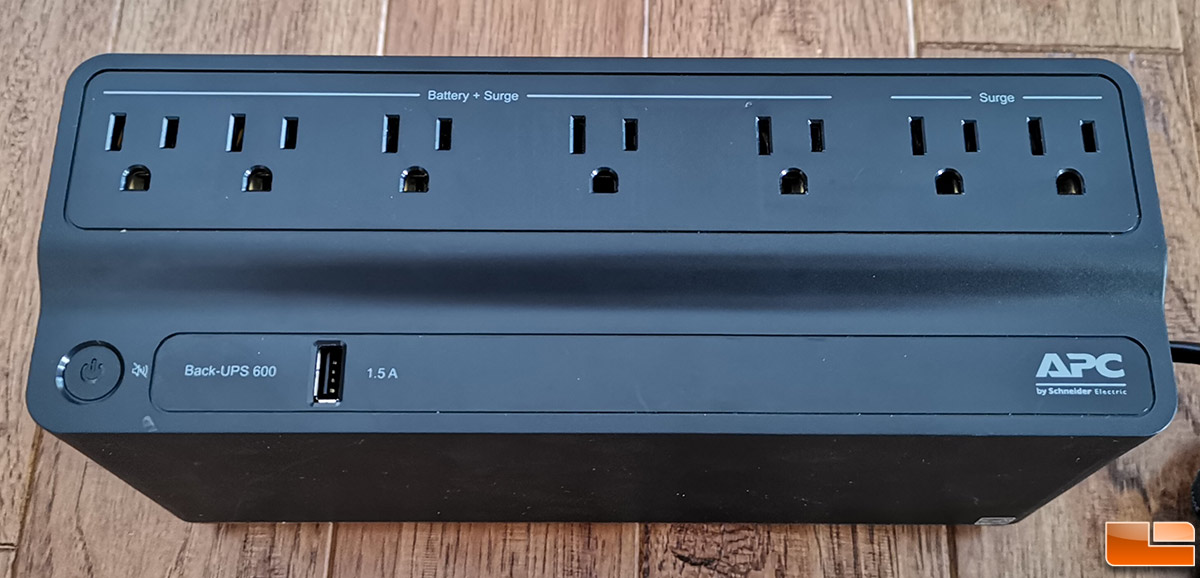

APC BE600M1 outlets
With the battery connected, I removed the warning sticker and was finally able to see all seven outlets. APC spaced some of the battery & surge outlets apart, but chances are some will still be blocked by bulky wall adapters. The power button is green and also works to silence the alarm. If you want further control of the alarm you’ll need to install APC PowerChute software.
