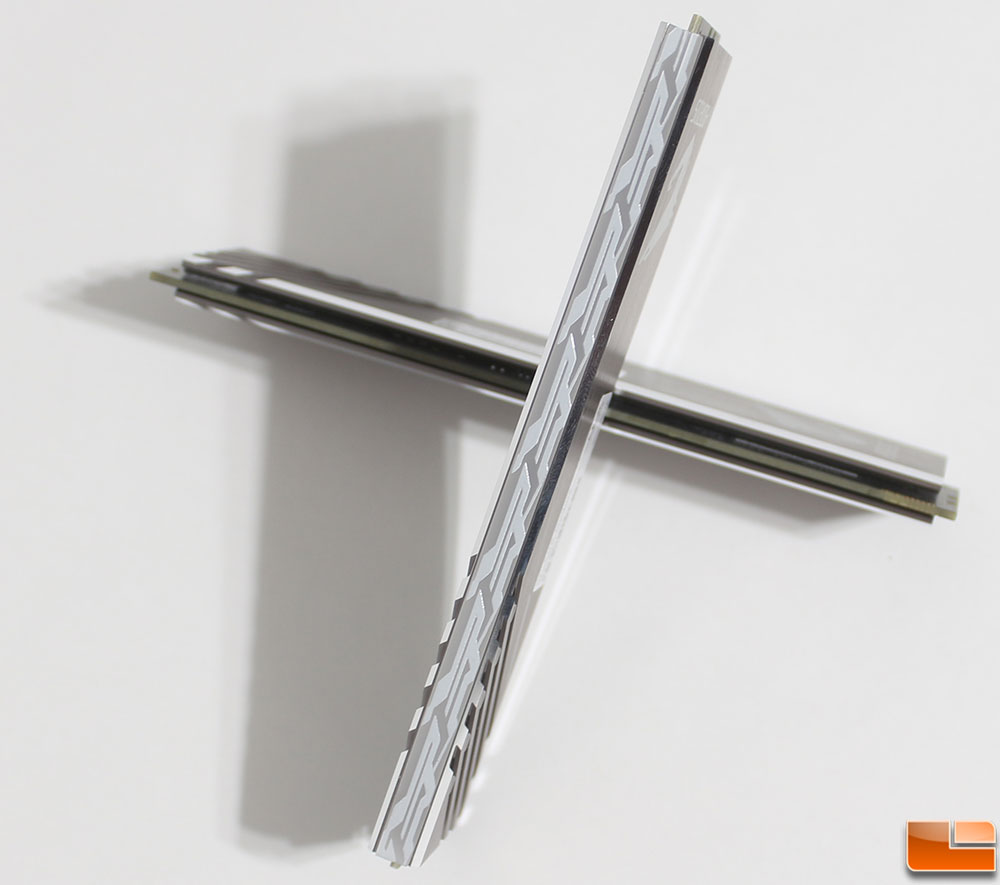

Along the top edge of the memory is the Aorus patterned light diffuser. This light diffuser should evenly distribute the lighting from the five RGB LEDs. While the Aorus pattern gives it a unique look both while the LEDs are shining through and while the system is off.
