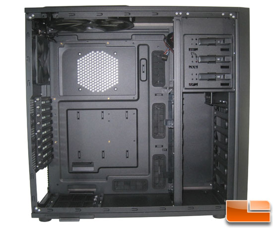

Those familiar with the previous Gaming Series cases will notice the drive cages are not like they used to be. They now go left to right rather than front to back.
There are 4 tool-less 5.25″ bays, 2 dedicated 2.5″ drive bays, and 6 slots for 3.5″ hard drives.
On the inside of side of the drive cage are two tool-less 120mm fan mounting spots.

Moving around to the right side, there are 4 grommeted wire routing holes down the side and bottom of the motherboard, and 2 open wire routing holes at the top. Antec also provided may places for wire ties to help keep things tidy. The CPU cut out in the motherboard tray is massive; there should be no issues getting to the back of CPU sockets.
From the tray to the side panel is 1″, absolutely cavern-like compared to past Antec cases. There is plenty of room for even the beefiest power supply’s main 24pin cable. To give a little more room, the right side panel has a bulge that gives almost another .25″ of space.
