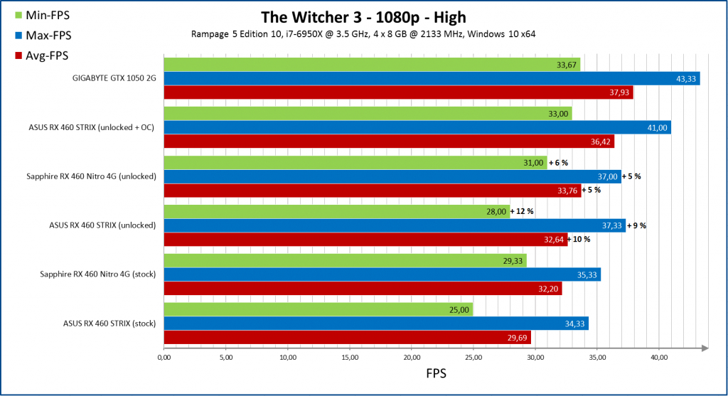

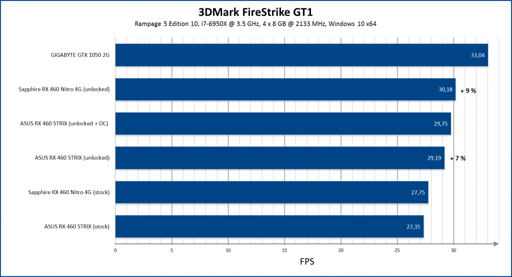

The site updated the BIOS on got this to work on the Sapphire Nitro Radeon RX 460 4G and the ASUS STRIX Radeon RX 460 O4G as they tested six cards and had success with all of them.
The theoretical performance gains were 12.5% and the actual tested performance gains in a couple quick benchmarks looked to be in the 7-9% range. The ASUS RX 460 STRIX card got a 7% performance gain in The Witcher 3.
