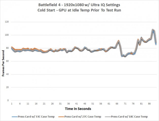

press-card-cold-fps
No huge difference here on the AMD Radeon R9 290X press sample card as all of the runs averaged right around 80FPS over the duration of the 90 second benchmark run.

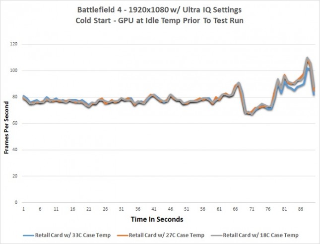

retail-card-cold-fps
bf4-retail-cold-clocks
The Sapphire Radeon R9 290X retail card appeared to run the same and was pegged at 1000MHz for the lower two temperature tests, but we found that the retail card started to throttle faster than the press card for some reason in our hottest test scenario. We repeated the test multiple times and the result was always the same. You can see in the FPS chart that the performance starts to drop below the other test runs due to the lower clock speeds.

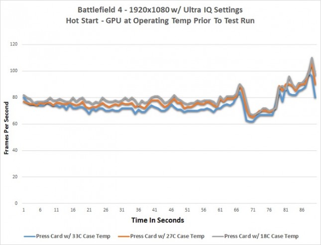

press-card-hot-fps

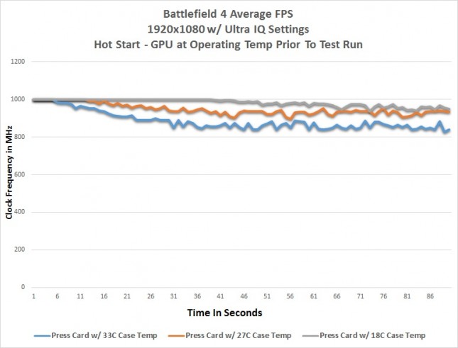

bf4-press-hot-clocks
Next we wanted to test the cards from a hot start. This means that we played BF4 for about 20 minutes on the AMD Radeon R9 290X to heat it up to it’s full operating temperature which is a toasty 94C. The AMD Radeon R9 290X press sample runs at the max clock speed of 1000MHz for nearly 45 seconds on the system with the coolest ambient temperature, but only maintained that speed for 12 seconds at 27C and for 4 seconds at 33C. As you can clearly see there is a significant difference between benchmarking the Radeon R9 290X in a ‘hot’ and ‘cold’ state and the ambient room/case temperature also plays a huge roll.

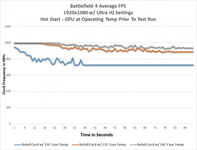

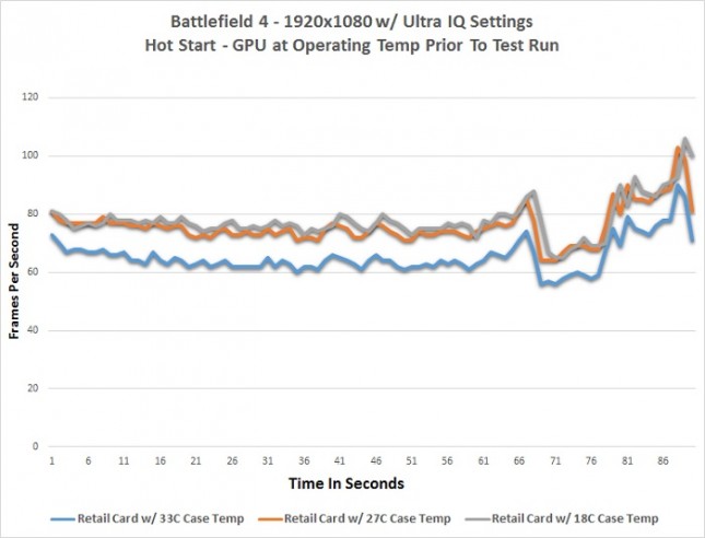

retail-card-hot-fps
bf4-retail-hot-clocks
When we ran the same test on the retail Radeon R9 290X from Newegg we saw similar performance decreases again, but they were much more drastic. The retail card was able to hold 1000MHz for 22 seconds with an 18C case temperature, 12 seconds at 27C and it was never able to run at 1000MHz inside the case at 33C. In fact, after 33 seconds the card bottomed out at 727MHz for the remainder of the benchmark and during our benchmark run.

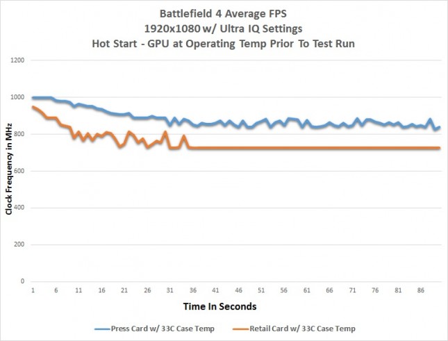

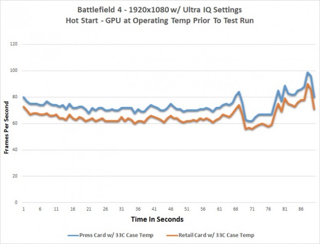

fps-compare
bf4-versus-hot-clocks
So in our worst case scenario the AMD Radeon R9 290X press card and retail card showed clear signs of throttling when things got warmer, but they weren’t close to being the same. Our test results from the chart above showed the press card averaged 880.86MHz over the course of the benchmark run versus just 752.95MHz on the retail card. This makes the retail cards clock speed roughly 14.5% lower than the press card in the same system with the same ambient temperature.
