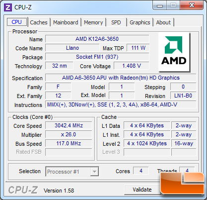

AMD A6-3650 APU Overclocking
With everything left to default in the BIOS and by just raising the back clock frequency we were able to reach 117MHz and then we hit a wall. The Gigabyte GA-A75M-UD4H motherboard uses the VGA display output as the primary video connection and that is what we were using. At any clock frequency over 117MHz our monitor would get an ‘out of scan range’ error. We had to clear the CMOS each time this happened until we finally went into the BIOS and enabled the dual link DVI connector. Once we were off the analog output and on the digital output we were able to continue increasing the bus speed without having to increase the voltage.
