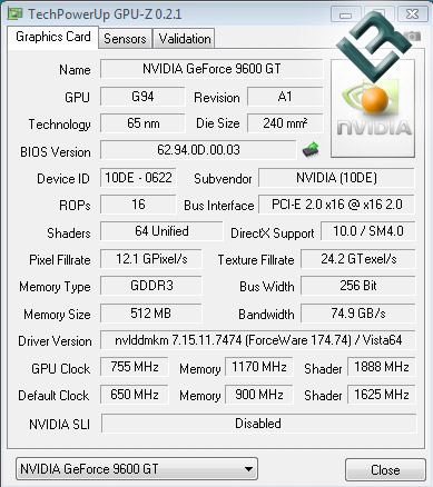

We were quite pleased with the overclocking we were able to do on this card. As you can see from the above screenshot from GPU-Z, the default speeds on the card are 650 MHz for the GPU clock, 900 MHz for the memory clock and 1625 MHz for the Shader clock. Using Powerstrip for our overclocking, we were able to get 755 MHz out of the GPU, 1170 MHz out of the memory and 1888 MHz out of the Shader clock. That is a pretty good overclock! Just to give you an example of the performance increase you will get from this oveclock, our Crysis scores looked like this with the overclocked settings:
