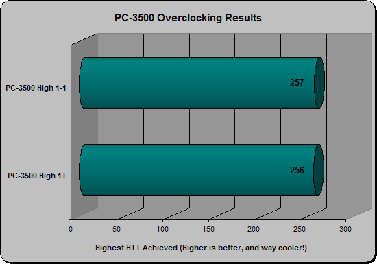

With the 3500LL, we were able to get to a high 1T overclock of HTT 256, running 2.5-3-3-8. This is a pretty nice overclock for sticks that are rated at DDR433. Strange to us was that we could only push it to HTT 257 when using a 2T rate. We tried loosening the timings even furtherto 2.5-4-4-8, and even 3-4-4-8. None of this helped in our overclocking efforts. I am not sure if it was the motherboard or the ram that was the issue, but this was strange behavior to say the least.

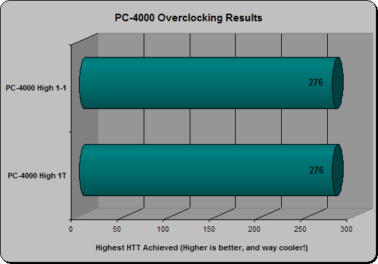

The PC-4000 also did respectable for itself, reaching a high 1T overclock of HTT 276 and 3-4-4-8. But once again, we faced a similiar situation in overclocking the PC-4000 that we did using the PC-3500. The highest we could do at a 2T command rate was the ecact same! HTT 276 was where it stopped! Don’t get me wrong, this was not bad at all, just unusual.
