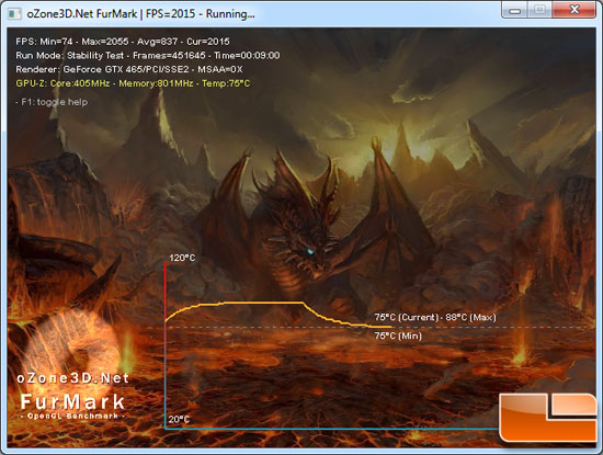

PNY GeForce GTX 465 Video Card Load Temperature Testing Results
We fired up FurMark and ran the stability at 640x480, which was enough to put the GPU at 100% load in order to get the highest load temperature possible. This application also charts the temperature results so you can see how the temperature rises and levels off, which is very nice. The GeForce GTX 465 maxed out at 88C. The fan on the GeForce GTX 465 video card was left on auto during temperature testing and the fan speed is dynamic. This means that it will increase/decrease depending on the GPU temp and GPU load. When we hit the space bar to stop the rendering the temperature dropped. Since a 2D application was open the GTX465 video card wouldn't go back to a complete idle state, but as you can see the temperature dropped and started to level off around 75C in this quick and simple test.
